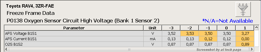

p.s. На фото - "виновник" DTC P0138 [Oxygen Sensor Circuit High Voltage (Bank 1 Sensor 2)] :
[quote="T-SB-0109-09 'MIL "ON" DTC P0138 and/or P0158 Diagnostic Tips"] ... Check the A/F and O2 sensor values for the appropriate bank DTC Freeze Frame Data (FFD). Is the AFS Voltage B#S1 = 3.35~3.70V AND the O2S B#S2 = 0.70~0.90V? • YES — Replace the appropriate bank Air Fuel Ratio Sensor ONLY (NOT O2 Sensor) to correct the P0138 or P0158 DTC condition. • NO — Inspect the O2 B#S2 circuit for open, short, or high resistance...[/quote]
RAV4 DTC P0138 FFD (fr.)
